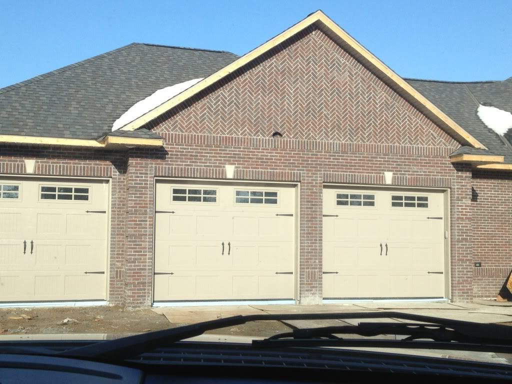

Does anyone have pictures of "decorative" brick laying that breaks up the vertical run of a brick section?
Our mason, without input from us, decided to break up the run of brick with a decorative run of bricks.
Makes more sense in the picture.
Not sure if I like it or not, but I don't have anything to compare it to. Any help/pictures appreciated.
Thanks,
Ray

  • DLM2000-GW
    The issue is ***without input from us*** and that shouldn't have happened.
    However....... I like it, it's well done, sheltered with your overhangs and a nice detail. I'd like to see it in the larger context of the house and wonder if it's going to be a repeated element (which I would want for continuity).

    I don't really like it. It will provide great spaces for bird nests and spider webs

    I can't tell if I like it without a picture from further away to get context, but the fact that you didn't dictate it would alone be enough to infuriate me. This has happened to us quite a few times in the planning process (we haven't started yet) but things show up as "surprises" often on designs/bids, so I don't think it's an uncommon problem. I can't figure out why it's not easier to just do what the homeowners ask!
    I'd probably ask them to re-do it unless you decide you really love it.

    We have one separating our first and second floor. Ours is a simple 3 row of bricks slightly pulled out from the rest - one pulled out a bit, the next pulled out more and the third back in where the first is. I like ours. I don't care for his pattern/design and I would have him remove it. It is sort of a strange looking design to me and doesn't seem to do anything for the house. I can't believe he did it without asking!!!!

    my questions to you are - is this the normal brick layer that your builder subs? and this is how they always do it? was the cost of materials/labor included in the bid? what did the outside elevation look like that you agreed on? how did you pick this builder, by looking at one of his models?
    If you don't like it, I'm sure it's going to cost you big to have it redone. I'd like to see a bigger picture (of the whole house) before I give my opinion.

    I think it's fine, and actually add some interest to an otherwise plain masonry wall.
    I think, however, I'd have a talk with the General Contractor to find out how the surprise happened, and what should be done to assure no further unplanned, unapproved surprises.

    From what I can see I like the way it looks but I agree that it would be nice to see what this looks like from a distance and also if this design feature is going to be repeated anywhere else which is probably necessary for 'continuity' which has already been mentioned.
    I would also talk to your builder about the subs using 'creative license'... could be expensive for the builder if you decide you do not like it.

    I wouldn't have thought to ask for it and I love it! And wouldn't be worried about birds at all in space as small as those.

    We have what my husband calls a "soldier" course of bricks between our 1st and 2nd floor. They stick out a few inches from the facade to give some interest. I like little touches like that...makes it look custom and thoughtfully designed.

    I like this -- it looks very much like the decorative courses on our 1927 former home.

    I like it too. I agree that it does give it character which makes a house look custom.

    Thanks for all the responses. The builder was awesome today. He said he would remove it if I don't like it but that the sub was trying to impress us (and him). The band is call sharks tooth and is usually an expensive upgrade that he was doing for free.
    The sharks tooth will be repeated in the other peak to give continuity.
    We will likely keep it as is. The brick needed something to break up the run.

    I like little brick accents like that, if not overdone. Yours certainly isn't and looks great. I wouldn't have the mason change a thing.

    My concern would be that the brickie is trying to distract you from noticing that he forgot to install weeps and/or thru-wall flashing at the window heads and the top of the foundation. But finding these problems is what I do on a job site.

    I like the way it looks but can't really tell in the pic if it might hold water in wind driven rain and could freeze in the winter.

    Are they deep enough to attract birds for nesting?
    If they are you will have a nice white 'decorative' effect from the birds below the holes unless you use nixalite or cover them in some way.

    I like brick accents. We did coined corners, a soldier course around the house and a herringbone pattern above the large garage gable. My husband is a bricklayer though, so I have to go along with his surprises. :) Here is a picture of ours:

    The brick mason finished both peaks and the accent really breaks up the run and with both peaks having the shark's tooth, it looks great.
    Plus, at 30 feet, it is very subtle which I prefer.
