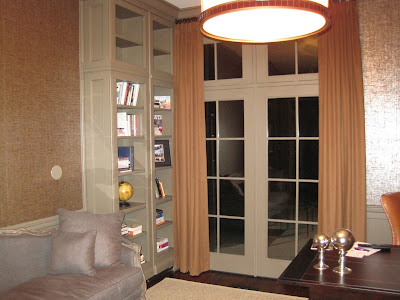

We had a similar condition. Our french doors and built-ins were touching one another. We were able to hang draperies - they conceal about a half of one of the doors. Our doors are fixed, so it isn't a huge deal. There is still plenty of light in the room and the views aren't compromised too much. Your drapery panel will need to be twice as wide as mine since you have 4 french doors, however you may have some room between your fixed door and built-in.
From Drop Box

Jo Ann - in hindsight I would have tried to leave at least another foot between the shelves and window.
