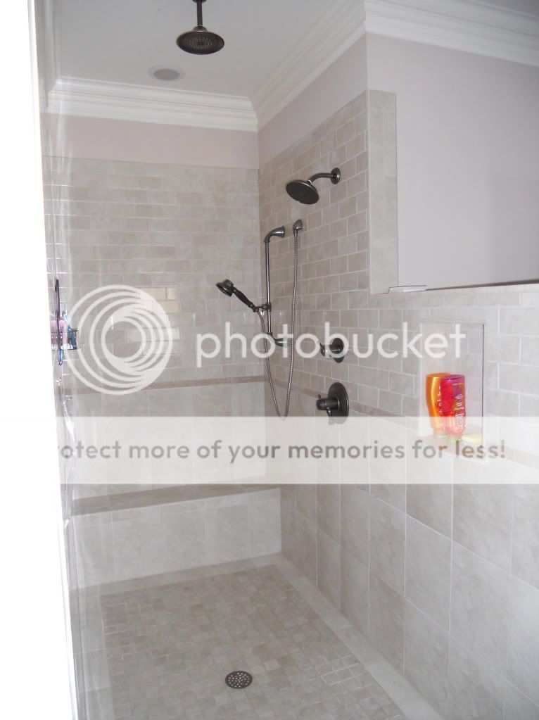

I vote tile floor, but with smaller tiles than 6x6. I've read too many nightmare stories of the pebble floor not draining well leaving standing water in your grout. I do have a question for you: If you don't want alot of grout, why are you looking at a pebble floor? Pebble floors have more grout than even a 2x2 tile floor. Compare the amount of grout (and the varied grout "lines") in tobler's pic above & the amount of grout in my shower using 2x2 tiles in the pic below. The reason for using smaller tiles in a shower floor is that the grout is what gives the traction under your feet to help prevent slipping and falling. The less grout you have, the greater your chances of slipping & falling--6x6 tiles leave very little grout and hence very little traction. You don't have to have huge grout lines either. They can be as small as 1/16". If you're worried about scrubbing, squeegee the walls and floor after every shower then spray an antibacterial cleaner (like Scrubbing Bubbles) once a week on the floor to kill any bacteria that may be there and rinse. That's all the maintenance you will need to do. Tobler has a beautiful shower and from their posts also squeegees to keep it looking like new.
Note: The shower floor was not completely dry when this photo was taken so you may see some variation in the grout color. When dry, it is all a Pearl or cream color. When wet, it turns more of a light brown color.

Tobler and Mydreamhouse, thank you for sharing the pictures. Both of your shower floors are beautiful!
