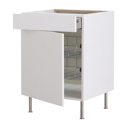

Why don't you get an 18" kitchen cabinet from Ikea, attach a false front on top for the sink, and a use a regular door? The false front and door could either be Ikea or custom. You could get a matching side panel as well to make it look more finished. Your counter and sink could then be whatever you want.
I used Ikea kitchen cabinets for one of my bathrooms.
Bath Thread with pics of Ikea base cabinets as vanity
Here is a link that might be useful: AKURUM Base cab
RE: Suggestions for a tiny bathroom?
The kitchen base cabinets are either 12 or 24" deep. That's either too shallow or a lot of extra inches vs the 15 for lillangen, and in a small bath it makes a difference.
If you're good at DIY you could always cut down the depth.
