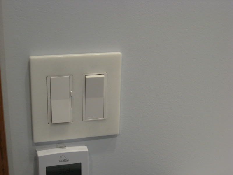

Hello. We're thinking about putting in radiant floor heating in our hallway bathroom which is tiny (5x8) but not sure if the thermostat would just look too big and bulky in the small space. Those who have this in their bathroom, can you please post a pic? Thank you.

    Both of our bathrooms with floor heat are small (4x7 and 5x7). We installed the thermostats just under the light switches.
