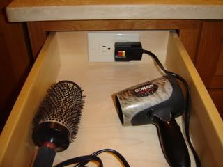

I have my hairdryer in my drawer, too. The outlet is also in the drawer! I love it. Another thing not on the countertop!

Linda-z: Verrry handy outlet! My husband wants to know how the electical is connected in the back. Does the back of the drawer have a wire into an electical box?

linda-z,
Could you please show us a pic of the outlet with the drawer out of the cabinet? I can't figure out how it works either, and is that within code?

I took pictures for you!
Here are the pictures of the "back sides."
This is the underside of my drawer (and the back side of my outlet in the drawer)
And this is where the wires go:
I hope this helps. It's not an extension cord, at least not in the classic sense.
And it passed inspection! I really do like it.

Outlets in cabinets and drawers are very handy.
Just be careful mounting the outlet to the movable drawer, as in linda-z's drawer. You can't use romex in that application (her's isn't) as romex is not intended to be subject to repeated flexing.

Mongoct and Linda-z: If that is not romex what is it? That's what we thought it was. Love the drawer, we want to do the same thing.

Almost looks like a "Seoprene" jacketed cable with stranded conductors. Not certain though. Good for repeated flexing, moisture, etc, etc.
"Romex" is more like standard gray, white, or yellow jacketed cable used for residential house wiring. The conductors are solid, not stranded. Not good for repeated flexing applications.

FWIW, my electrician refused to wire a drawer for me. He says he has a real issue with the safety of this. He thinks heating appliances should never be left plugged in, especially in an enclosed area as they can be accidentally triggered on and create a fire hazard.

I don't understand the "standard cords are not meant to be flexible" part. All electrical cords that I own are flexible (not rigid) My hairdyer is connected to the outlet behind a drawer in my vanity. It's no different than if it (hairdryer) was sitting on top of my vanity and plugged into the wall just above the vanity. It's used the same way, it's just placed lower and out of sight. The bulk of the cord is IN the drawer that my hairdyer is in.

he's not referring to the electrical cords you use for hair dryers, etc., he's referring to the cord from the outlet to the wall (as mongo said - the standard cord is romex and is not flexible)...
RE: Please show me how to hide the hair dryer,etc...
It's not that romex isn't flexible, it is. But it's not meant to be repeatedly flexed and re-flexed as it would be if it was attached to the back of the drawer. It would be stressed over and over in the same place with the opening and closing of the drawer. If you take a plain piece of wire and bend it, straighten it over and over, eventually it breaks - that's what happens inside the romex.

understood, thanks dlm - so what's the best wire to use?
