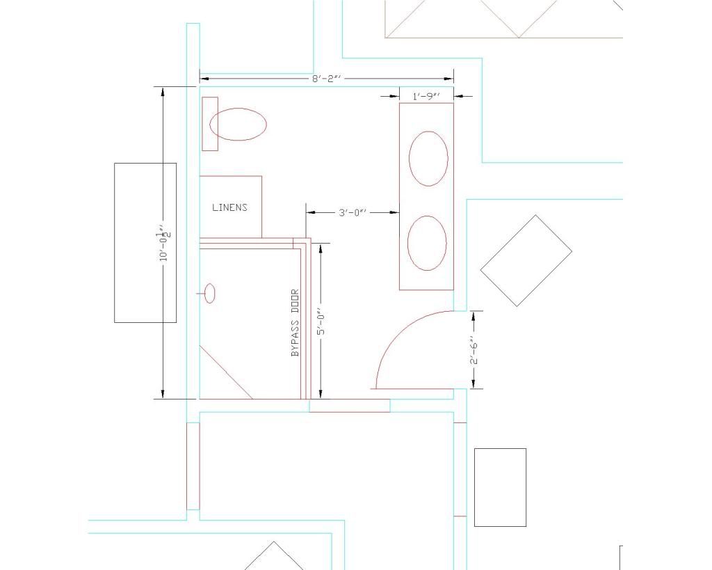

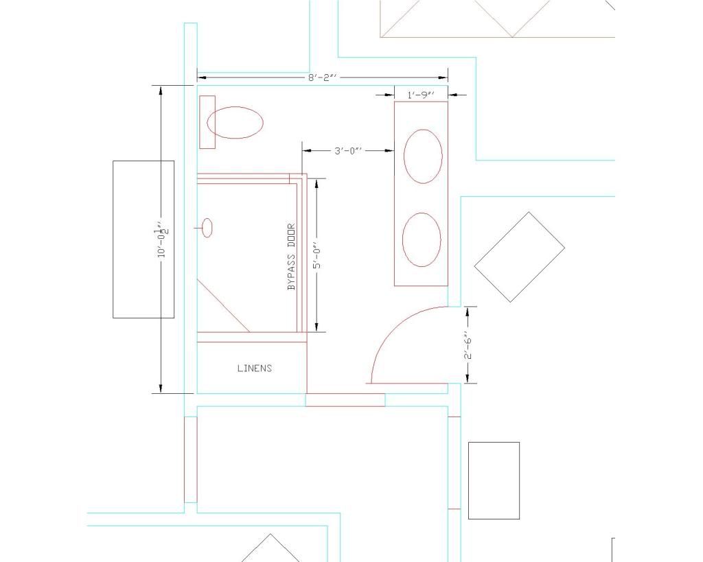

I have been lurking for some time admiring the many bathroom renovations that have been done on this forum. Well now it is my turn and I am hoping to get some feedback on some initial floor plans that I have put together. Option 1 is a doorless option, the others are combinations of rectangular frameless shower arrangements. The Master Bedroom in to the right and below the Master Bath is a hallway that we are hoping to convert into a closet for the Master Bedroom. That area is not finalized so options to extend into this area, or do some built in linen closets into this area are not off the table. Any thoughts?
Option1:
Options 2:
Option 3:
Option 4:

Personally I like your first drawing, for starters it looks to me that you could enter that shower with out the need for a shower door. You also show a space for storage. With proper lighting you could make that shower space tiled walls and do away with the shower door. It would close it up but would also hide the toilet. Option 3 the linen closet is way too deep. Deep closets are a pain they just don't function well. I like the longer counter on the others if you could get lots of storage into them. Also I have seen some really nice recessed tall thin cabinets you could park on that 8'2" wall. I think tall thin cabinets gives you many opportunities for storage and organization. There are some inexpensive computer design softwares out there and you could do a mock up and walk around the room and see how it looks.

I like option 4. With option 1, you only get a 5' for a double vanity which is tight. In option 4, when the bathroom door is closed, it will feel spacious when you get out of the shower.

Thanks for the feedback.
jjaazzy - I was planning on the first option being a doorless shower. I was thinking that the wall next to the toilet could be a solid wall, with glass along the other side to give a more open feeling.
pps7 - I went home a measured, and I actually have a window that is too close to the corner to allow the linen cabinet in Option 1. I would therefore probably opt with installing the larger double vanity and just use the storage under the double vanity in lieu of the linen closer. Or maybe I could be some recessed in the hallway space.

I like #1 the best -- it's the most interesting shower and provides privacy for the toilet.

Surprisingly, I like option 3 the best because it allows for more counter space and elbow room. Our counter is 93 inches long and I love that there is ample space for both of us.
Another option is you could use one of those linen cabinets that sit on top of the counter as opposed to a floor to ceiling one.
