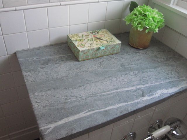

    Yes, I made the sink, the backsplash/counter, and nearby counter at the tub. These were remnant pieces that where limited in size. It was a very soft and dramatic stone. I have it sanded to a fairly rough texture and I love it. It never shows any scratches but it scratches easily. Here is a picture of the room overall:

    Leela4, I think the grit was around 120 or maybe even as course as 80. But the color is spectacular on this stone. I have another, harder soapstone that looks like a block of cement when rough - not pretty at all.
    This counter is the same stone as the sink and it is 2 strips epoxied together down the long side because all my pieces except for the sink bottom where about 11" wide.

    Oh enduring-that counter is so beautiful.
