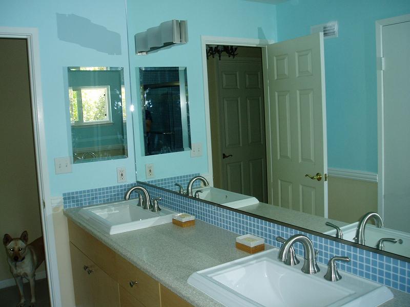

Do you think the outlet should be the same height as the light switch? I guess the electrician did it this way because of the code, but I'm not sure I'm liking how it looks.

From the taped joint, it suggests that there was blocking which prevented the duplex gangbox from being aligned with the triple. Unless your contractor can offer a rational argument, other than "I couldn't put it there", I'd have him offer a more attractive relocation solution.

There's nothing blocking it, I'm sure. I didn't get to take a picture before the wall went up. I thought I'd ask while there's probably still time to change it.

I would have him change it. If there's nothing blocking it, he took the easy way out.
RE: Does this outlet look right?
I think he just followed standard height guidelines for an outlet and for a wall switch, which are not exactly the same. I see this type of arrangement in commercial settings.
That said I would want it changed so it looked better. I don't think the code is so inflexible that it needs to stay this way.

I asked yesterday, and was told is was because of the code. The light switch was originally the same level as the outlet, but the electrician moved is up so the bottom is 48" from the floor. DH doesn't want me to "complain" about the placement. He feels the professionals know what they're doing, and that it'll look fine when it's all finished. I'm still thinking I'll regret not having it changed while there's still time.

As noted, there's no code reason why the receptacle couldn't be moved higher to match the height of the switches. Listen to your head: if you feel the disparity in heights will bother you (as it certainly would bother me), have him change it now.
Through several major renovation projects, I've worked with electricians who are undoubtedly fine electricians -- but I've learned to trust my sense of aesthetics, not theirs! (By the time of our latest bathroom project, I learned to specify everything down to the last detail in terms of placement, which switch to place where in a multi-gang box, and what type and color of switch/dimmer/timer/receptacle/faceplate I want. Both I and the electrician end up happier this way!)

I thought I didn't have a picture before the Sheetrock went up, but I found one that I stuck in the wrong folder. There will be a nightlight in the outlet that's higher than the top, so if the outlet isn't moved it might not look weird.

I'm aware of the upside down plug. That and the light switches are only temporary while the GC is working. The electrician will replace them later, and there will be a GFCI too.
I went to visit my parents today. I looked in their two bathrooms, and both of them had the outlet lower than the switch on the same wall. I guess it's not that uncommon.

Our outlets are lower than the switches, too. Never noticed it before and it's never bothered me. I actually think it would look weird to have an outlet that high and level with the switch now that I'm trying to picture it.

I walked around my house out of curiosity and wherever there is an outlet on the wall near a switch they are exactly the same height. I cannot imagine them being differently and I would simply tell the electrician that you would prefer the outlet to be even with the triple switches.

It looks like there is a mirrored medecine cabinet on that wall which would explain why that outlet was installed lower than the switch. Since you have no obstruction, that isn't really an apples to apples comparison. Also, from the fact that they were originally at the same height (before he realized the switches were not to code) I think it's pretty clear that the standard is to have outlets and switches at the same level. He just didn't want to have to move both of them!
