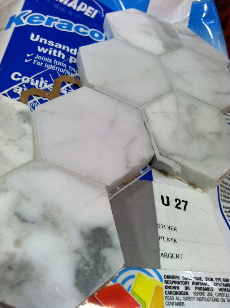

    alright, here it is next to two mapei colors--are either of these choices better?
  • enduring
    I like the 2nd one of these two grout colors. The first one still looks like it has purple in it and maybe too dark. The 2nd one looks a bit lighter and more of a neutral color gray.

    I also like the second Mapei color (the lighter one).
