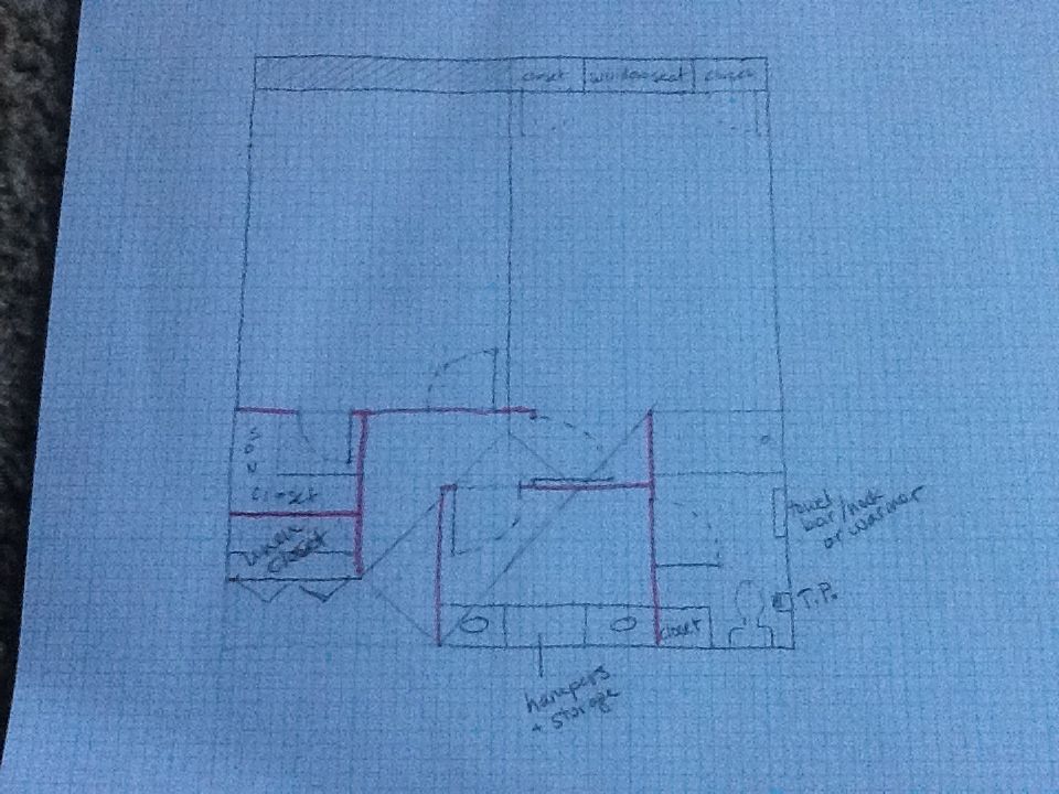

Well, I would get rid of the angles. They eat up a lot of your space. What about this? I dew over the existing plan, new walls in pink highlighter.

How about this? It's just the lower right corner reworked. You can put in whatever size vanity you want on either side, and use some space for a lowered counter seated area, or storage cabinets, or other useful stuff. But each child has their own side.
You can also easily make 2 separate bathrooms if you lose the angles. Just put a sink in the right room where it says hampers, and in the left room replace one vanity with a tub and put the toilet in front of the door.
