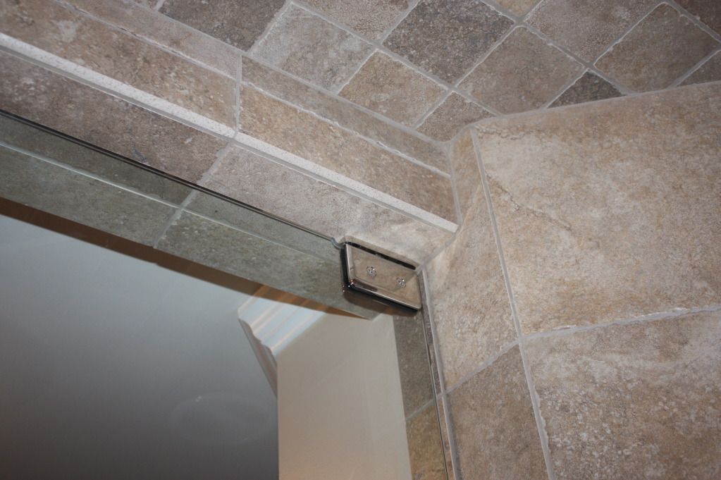

If you would consider taking the glass all the way up to a small soffit near the ceiing, you could use pivot hinges at the top and bottom without a header. The door swings in or out which is helpful in a small room. We wanted to minimize hardware so we did this in our masterbath. We have a good vent fan in the shower and keep the door open (in) when the shower is not in use.
