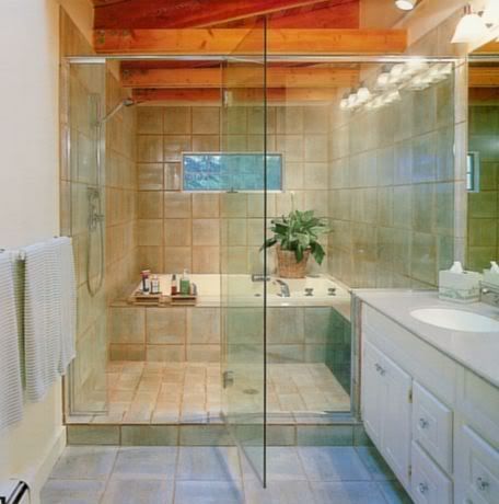

  • sundownr
    14 years ago
    I have a long narrow bathroom and I have considered what appletini mentioned after I saw these photos on a blog. A real tub and a real shower in a space where it really shouldn't fit. :)
  • lindiver
    14 years ago
    Those pictures are wonderful. I love the idea of having the shower (wet room?) and tub together like that. Thanks so much for posting them. You've given me another direction to follow.
  • palimpsest
    14 years ago
    Those baths look to be 6' and 7' wide respectively, but the principle is still the same, --yours won't be as roomy looking. It will still function the same way.
