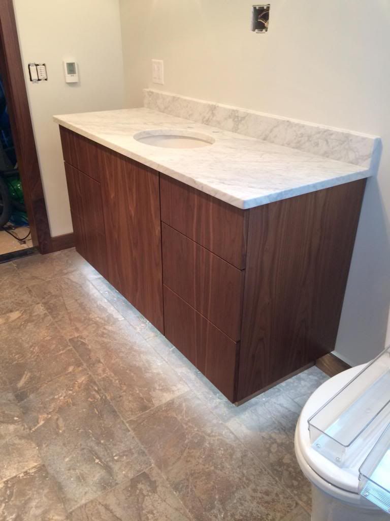

  • DeeV78
    9 years ago
    Here's a pic, may may not be too helpful.

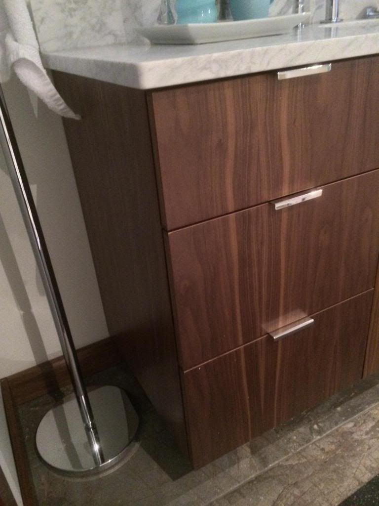

  • enduring
    9 years ago
    I have around 12 inches between my side wall and the vanity. I wanted a stand alone look. I have a towel tree in the 12" space, but it could be any thing. I have my vanity trimmed out on both sides so it looks more finished.

  • enduring
    9 years ago
    If that is your vanity, then it is meant to stand away from the wall. It would look funny against a side wall, IMHO. My vanity is toe kick only around the bottom, but I was totally going for a furniture look like what you have in your link. It will be nice having it away from your doorway. I could store a scale in my side area if I didn't already have another place for the scale.
    Off topic: I have a built in laundry/linen cabinet on the other side of the room from the vanity. I put in a 12" deep toe kick to accommodate my scale :) I place the scale on a square of clear durable refrigerator plastic liner with ridges that I picked up somewhere. I slide the scale in and out by grabbing the end of the liner. Because of the ridges the sheet stays stiff enough that it doesn't buckle up when I push the scale back in under the toe kick. It makes it so easy to push back and forth.
