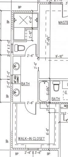

Hi everyone. I posted this on the building forum, but thought I'd try here too. We are in the process of drawing up the plans for our new home and need some help figuring out the master suite. We have a 21 x 23 space to work with for both master bedroom and bath. Whenever I draw out the bedroom to the size and layout I like, the bathroom ends up getting really long and skinny (approx 6 feet deep and 20 feet long). I'm worried that a long, narrow bathroom may feel more like a hallway. Does anyone have a bathroom layout like this? Do you like it?
I've attached 3 different options, but are hoping to find the best solution (which we probably don't have identified yet). A few things about the space - the area is the bonus room above the garage, so there can be windows on all sides except along the right wall. The doorway into the room needs to stay in the same vicinity and the windows running across the bump out need to stay to make the front of the house look nice.
We'd really like there to be a separate toilet room, a free standing tub, and a separate shower that's at least 4x5.
Other than that, the rooms can be switched around, closets moved, whatever will give us the best layout. Thanks in advance for your help!

Here's the 2nd option...

And here's the version that our designer came up with. There isn't much wall space with this layout and seems to be wasted space by the entry, so I was hoping to figure out a way to make better use of the space, but it's proving to be difficult for my novice skillset!
RE: Anyone like their long, narrow bathroom?
Well, actually, I prefer your designer's option best.
Generally, you'll probably have the best utility with a square layout. You might consider matching the bathroom door location with the closet door location (ie on the angle), but that might not work... It would, however, give you more wall space.
I don't like option 2 because, I don't like to be the person on the far side of the bed in the middle of the night racing to the bathroom... it is a long walk from the right side of the bed (as you are laying on it) around the bed, to the bathroom. Just saying.
Another option would be to square out the corner of the bathroom in the designer's option, so you have a place in your room to tuck a wardrobe/dresser that is a little better than the presently drawn location next to the closet.
One thing to answer: Are you going to need a separate dresser if you have 2 walk in closets?

I am leaning towards a version of Option 1. Seems like a double vanity may be the way to go. And if we push the back wall out a foot and use a small free-standing tub like Kevin's, then I can get a double vanity across from the tub and still have 3 1/2 feet of walking space.

I think I'd put the linen cabinet between your pocket door and your toilet door along the toilet wall. Then, you can slide your vanity over a bit (and even make it a little longer) to allow for a slightly larger entry door to the bathroom.
This is a much better rearrangement.
I LOVE your revised layout!
Did you mean to put two linen closets in there? If not, I'd keep the one by the toilet and nix the one by the shower. But, it still works if you want them both.

Mamattorney - Thanks so much! I did mean to add two. It seemed like a 7 foot toilet room was a bit long and it's nice to have a place to store the TP. But I didn't want to walk into the toilet room to get the towels. I'll switch up the layout a bit based on Kirkhalls suggestions and see how it looks.

I prefered Option 1 even before the tweaks, and after the tweaks I think its even better. I didn't like the Bedroom layout in the other options, particularly Option 3, where it felt crammed along that wall.
I also wanted to say we're in midst of remodeling and our Master bath is also long and narrow. Its only framed now, and the core measures 8 ft. wide by 18 ft. long, not including closets, shower, or water closet room. There's a long double vanity in middle, with 5X5 shower across the way. And instead of a tub, we opted for a nice built in dressing table area at the far end, along with linen tower storage. I think its going to be just fine, as the 3 most common spots (shower, sink, and closet entrance) are all near the bathroom entrance off our master bedroom. Wife will have to walk the length of room to get to dressing table. But then again I think it will be fine, as it gives it a bit of a "secluded destination" once you've arrived and sit down.

Here is the drawing of our bath I spoke about above.
I didn't realize the linen cabinet would be in the toilet room. I thought it was a closet that would open to the main area of the bath. Our linen closet - next to shower in pics - has only a 14" door, but the inside is about 19ish" across. Because it goes from floor to ceiling, it fits everything, not for the full house, but everything for the master, plus some. You could put the towels in there and not have to go into the toilet room to get them.
Or another idea if you think 4ft is too deep for a linen closet would be to divide the space into multiple parts - front and back (with the back being the west side of your drawing) and have the front open to the bathroom to store sheets and towels and the back or part of the back open into the toilet room and hold toilet paper and cleaning products. Seems like something that would work.

All three of your designs are have a problem in that they only have windows on one side of the bedroom. Generally people are drawn to rooms with windows on at least two sides and avoid rooms with windows on only one side. Your designer's layout gets that. (You can read a lot more about this in Alexander's A Pattern Language if you wish.)
Since this seems to be a custom designed home I think the window issue could be a serious mistake, unless a very dark bedroom for sleeping is a priority and the bedroom isn't used for anything but sleeping.
This is in regards to your closet. Have you considered making it one open closet - no wall between the two. Seems like it would give you more space and in between the two doors you may be able to add built in shelves for more storage.
Or were you planning on running your shelves along the two short walls? If you tweak your plans, you might be able to gain more storage space out of that area.
