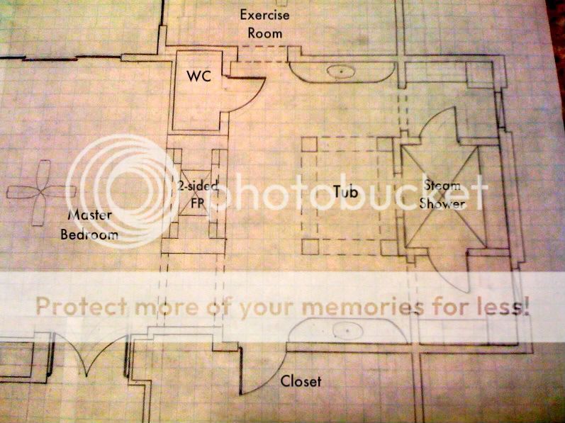

    Here is our rough draft pencil sketch (sorry it's so rudimentary, we're not ready to give our plan to the draftsman just yet!) of the master bath:

  • xedos
    What are those areas the steamer doors open up into?
