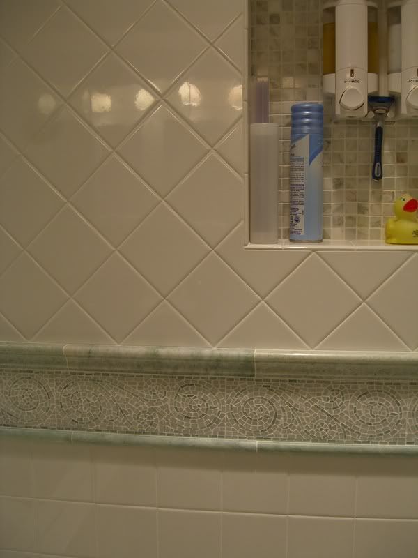

We did cheap Daltile field tile with an expensive marble border, and I think it came out great. Here are a couple of photos:

Beautiful mlk58! That floor is gorgeous!
