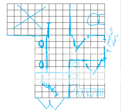

    Your plans are very ambitious for the space. I had to do some math first to see if you even have the square footage to do all that. I figure about 167 sq ft with about 112 sq ft without the walk-in closet, and I'm not sure that allows enough walking space and standing space in front of the vanity. I know it doesn't allow for anything that means less than perfect use of the space -- like the window, the small dogleg, multiple doorways, etc. I tried to see if I was up to a challenge I didn't come up with anything I would want.
    You may be able to get the function you want from your space if you are willing to make some compromises on what I would call grand style issues in favor of efficiency. I would start with stacking the washer and dryer and cut that space down. Consider wall closets instead of a walk-in. That walk-in is a big waste of square footage you don't have. Does your water closet require a full door or would a pony wall work for you?

    I have attached my original drawing I like the best. There are two big issues:
    1 - not sure everything fits just right and I will have enough walk space
    2 - We would like natural light in the bathroom but this version cuts it off

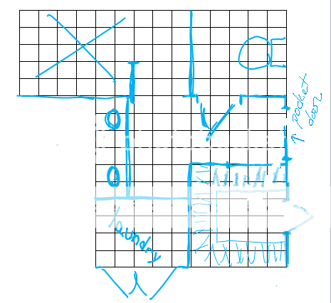

    This is my other design although I am not sure if the closet space is adequate? I can always bump that space out by another 6 inches if necessary - the entire wall just can not move due to another window.

    You can absolutely have a large capacity W/D and stack them. My LG pair were the largest sold at the time and we were planning to stack them. Haven't so far. LG makes arger ones now, but I am still amazed how large the loads can be. I am looking at 8 pairs of jeans I folded plus I know my DH had another pair plus a pair of shorts in that load. I may have thrown in a beach towel or two. I know I can get 2 sets of queen sheets in one load if they are standard weight. A king set and a twin set will fit.
    What is the distance from the nearest wall to the window? How high is the window from the wall and what is it's height?
