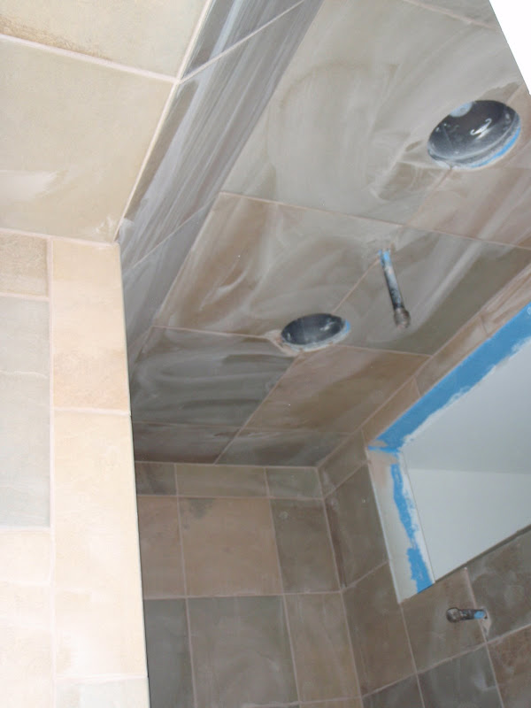

    I'm coming to this a little late in the conversation, but we did tile the ceiling to our walk-in shower
    you'll have to pardon the filthy picture - this was when it was just grouted! It's also a little tricky to get a good shot of the space, but I can try to get more next week (we move in on thursday!! whoo hoo!!)

    Bill - it was a pro! Now I hope you aren't gonna tell me it was a bad tile job - it looks good (now that it's clean)!!! I can't imagine how long it would have taken us to do it ourselves - I'm soooo impressed by everyone's DIY jobs. While my DH and I are quite handy, it took him 2 years to do our current master :-)
  • bill_vincent
    15 years ago
    No, there's nothing (I see) wrong with the tile, but if one of my guys left that much grout on the face of the tile, there'd be hell to pay.
