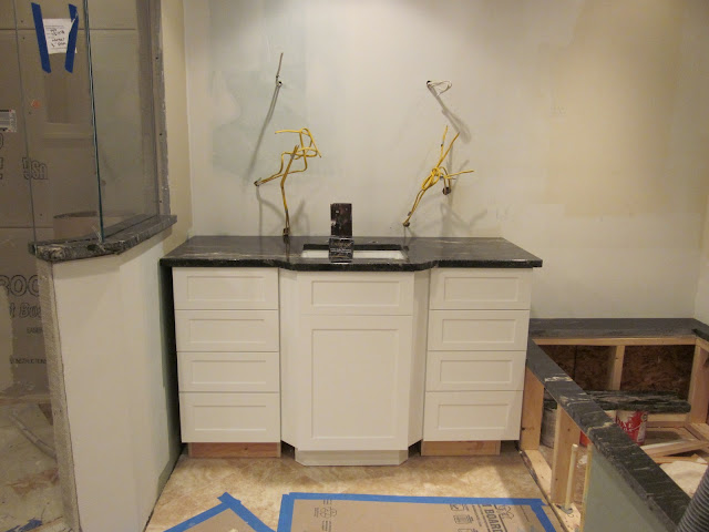

The glass went in first - in a shallow U channel adhered with silicone. Then, the tile and granite were installed. Here are a couple of shots before the tile went in.
In retrospect, we should have done the tile work on the knee walls before the glass went on and the granite was templated. The fabricator should have made a second trip for that. The Granite isn't exactly right, but hopefully no one will notice!

RE: TreasureTheDay: Your Shower Glass & Handle?
Chays - Thanks so much for the post. This is so clever! And what a clean look. What will you be doing for the door? Will you use clips? Pivot hinges, like TreasureTheDay did?
BTW, your bathroom looks beautiful. I'm looking forward to the finished pictures.
