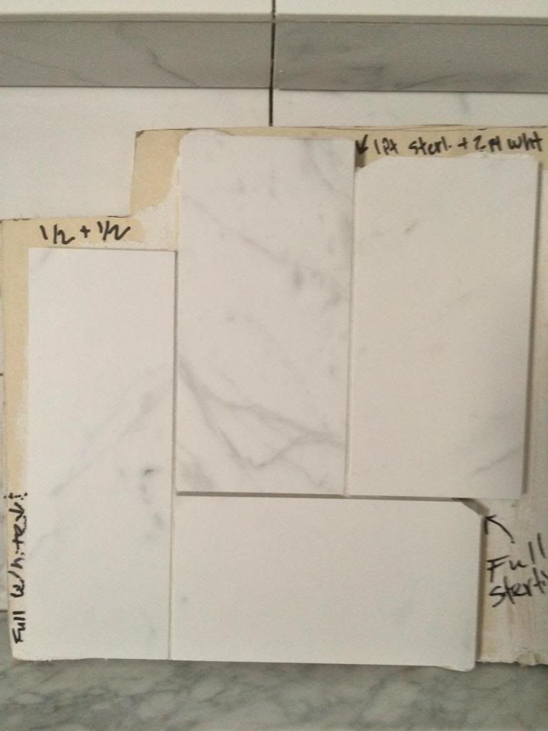

    Have you done a sample board? I always have pretty good luck with laying a few tiles on some scraps of drywall, or what ever, then after the thin set is dried, I use several of my options to see what I think. There are too many tones and shades to take a risk of getting it wrong IMHO. I don't know what Sable Brown is and it may or may not work. Do you want the grout to "pop" or to recede within the tile work. With your tile I would probably select something that recedes, but others may not. Then I have to consider if the selection is a warm tone or a cool tone and select accordingly. For example in my first bathroom I used a cool light gray for my white field tiles. In my current bathroom I have selected a warm gray and will mix it with white to lighten it up. But I have always mixed my grout to get the tone I want. Most people don't do that. I have a history of art, so it is not uncommon for me to mix and reform things. If you do decide to mix your grout, use exact measurements - dry measure or weight and record. I use Laticrete which is very consistent in color from batch to batch. It is a very high quality product.
    Here is an example of my grout sample board:
