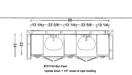

How many inches of counter is ideal between front edge and sink?
threeapples
I'm looking at the Kohler Devonshire, which comes in two sizes, 18 3/4" x 15 1/4" OR 20 1/2" x 16 1/2". I have not yet chosen our faucets, but here is our vanity, with dimensions.
Comments (18)
  • mydreamhome
    3-4" from counter edge to sink edge is common. It looks like your sink bases are deeper than the adjacent (drawer?) bases. If so, what are the depth measurements? The way the sinks are drawn in will give too much space between the edge of the counter and the edge of the sink which can make things like leaning over the sink while brushing your teeth a little more challenging. And you can forget cleaning behind the faucets with how close they're drawn to the wall. I would pull your sinks forward to remedy both these issues.
    Hope this helps!

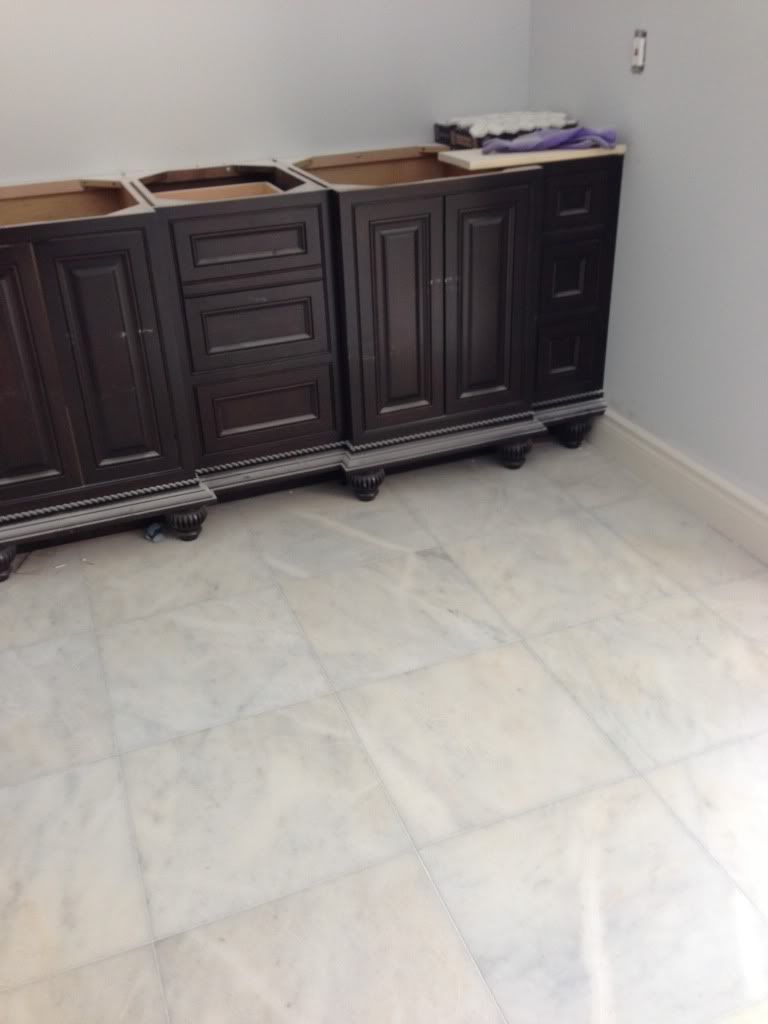

  • threeapples
    Thanks, my dreamhome. Here is a photo of our vanity installed:
