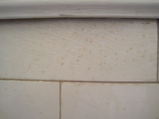

    To use the tiles from a almost 90 year old house as an example of whether or not to use crackle seems silly, as the tiles are made differently today, and I doubt they were sealed back then, and even if they did have sealer then, I'm sure it's made very differently today. Not to say crackle wouldn't have problems, but it's comparing apples and oranges, unless the tile was installed in the last 5-10 years and sealed. Good luck with your redo though.
  • bill_vincent
    14 years ago
    No they're not. Not crackle glaze.
    As for the sealer, that has nothing to do with it. The problem is that sealer will not wear perfectly evenly across the whole tile surface. You'll have areas that will wear faster, whether due to abrasion (no matter how soft), or soap alkalis eating away at it, or whatever. Doesn't matter if it's one of the silicone sealers they used years ago, or the more modern solvent based sealers we use today. The problem would be exactly the same, so it IS apples to apples.
