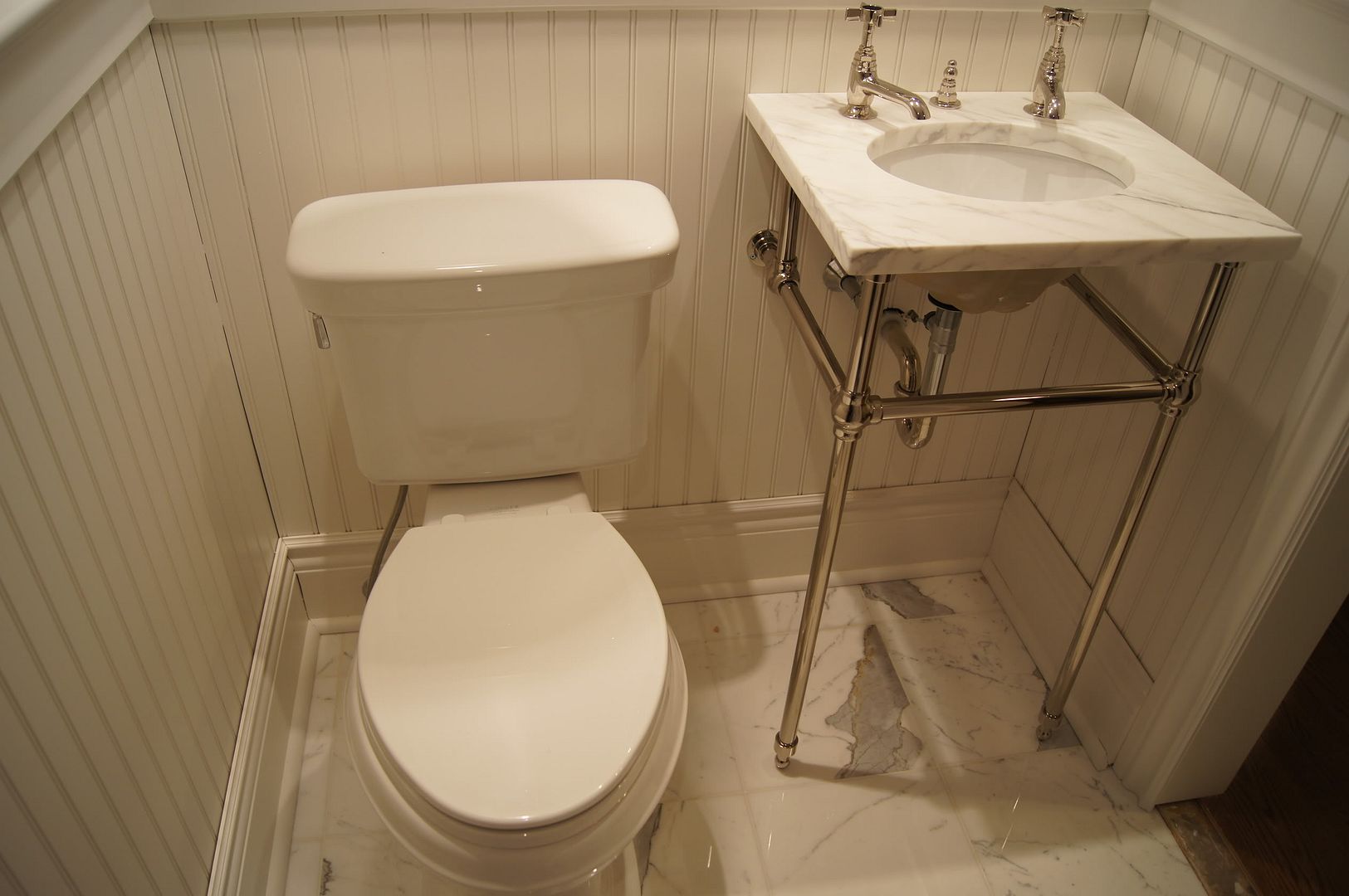

  • Tim
    I mulled this over for our small basement bath - 12x12 marble tile in a 5 x 7 space. Was going to go diagonal but settled on a simple layout and I think it was the right choice.

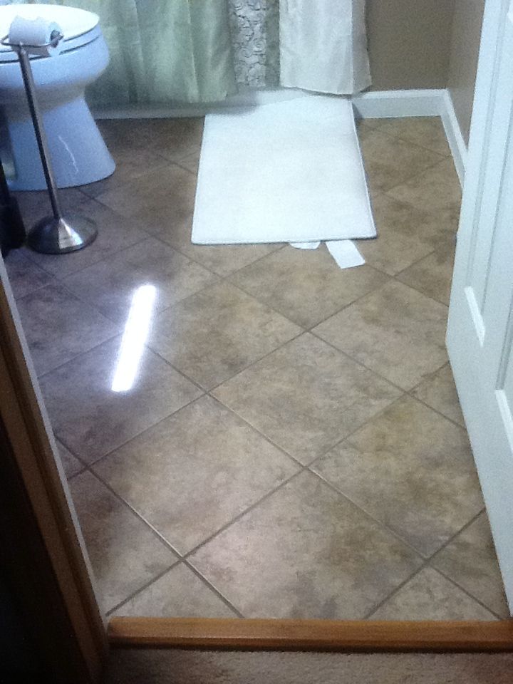

  • Karenseb
    I think it depends on the tile and pattern. The marble floor would probably not gain much by putting the tile on a diagonal. We put a large porcelain travertine look tile (16 X 16 ) in our lower level bath on the diagonal and I believe it opens up the space somewhat. It was more of a challenge to lay in a small space, but I like it and would do it again.
  • janesylvia
    Torontotim, thank you so much for sharing your pictures. The floor looks gorgeous.

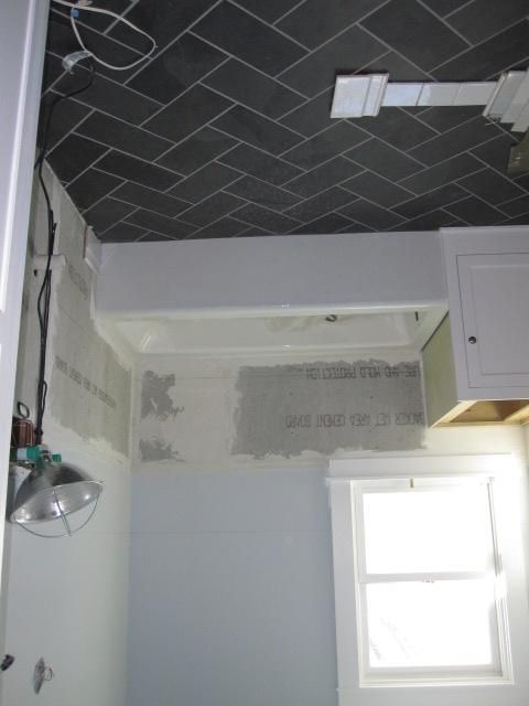

  • elphaba_gw
    We used porcelain plank on our bath floor instead of square and we are not finished yet but here's one of the earlier phases in progress showing the plank on the diagonal. This section of the curbless shower was 5ft by 5ft giving you a sense of scale. I would most definitely do this again. Floor is one of the most striking features of the bath. I'll be showing the whole bath eventually but don't have all of the accessories yet.
    I understand that this color and style is totally different from yours but guess I wanted to take this opportunity to show off a little, LOL.

  • Karenseb
    Jane,
    We also tiled the family/pool room and hallway downstairs on the lower level on concrete. The only thing I would have done differently would have been to make sure the floor was level (use a liquid leveler).
    The bathroom was 5 X9 feet 10 inches with a tub at the end.
    We actually did it ourselves and I took quite a while to figure how to lay it out in the family room to get it centered on the lower level floor as you came down the stairs and also down the hall to the bathroom. They usually do charge more for a diagonal layout, but I disagree that there is more cutting or waste. If you are laying properly, you are most likely going to have to cut tile on both sides of the room, unless you are unusually lucky. Maybe you could make a small diagram of the room and figure it out. We did use a good wet saw.
    My daughter had her tile laid on a diagonal and was not charged more.
