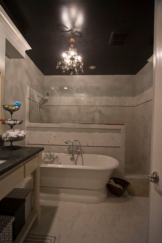

  • williamsem
    You'd have to draw it a little better to get the measurements right (hard to draw with my finger, sorry), but here's something different. I'm no expert, but I like tossing ideas out. Never know what might spark something!
    {{gwi:1405128}}

    My bathroom dimensions are similar to yours. Mine is appx 8x20. I don't have a tub but one would probably fit in front of the door where I have the cabinet. The toilet part of my bathroom isn't as deep as the closet next to it. We made a closet for another bedroom behind the toilet.
    Here is a link that might be useful: Pictures of my bathroom start here

  • Karenseb
    I like William's idea. You could do the toilet in an alcove and if you want two sinks set one into the closet space along with a small linen cabinet.
    --You could increase closet space a little by shortening the shower and long vanity and move the vanities and toilet alcove toward the window another 6 inches or so.
