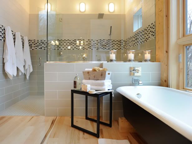

Yea, I dunno, I think I just like it being separate and dry, not really sure why either. I got the idea from this shower.

bjewell1- You were posting as I was so I didn't get to see the photo. Very nice inspiration photo. When I first looked at this photo I didn't even see the glass door--I thought it was just a doorway into the shower at the hardwood to tile transition. You can have a very similar look by extending the shower wall all the way to the toilet wall and placing the doorway into the shower opposite the vanity as I mentioned above. Install 3 towel hooks along the toilet room wall and you will have an almost identical look. With that setup, you don't have to worry about whether or not 2' is wide enough in the dry off area, you have plenty of room for both showering & drying off + it saves you $$$.
I can tell you my shower is 4'x7' with the shower head on the 7' wall & no door. We do not have a problem with water splashing out & it's not chilly. We have 2 full height tiled walls, a 5' tall pony wall and the open end. With the glass on top of the 1/2 walls like you are planning, it definitely should not be chilly--the wall and glass will help to hold the heat in + even at 3' wide, your doorway would be smaller than mine.
