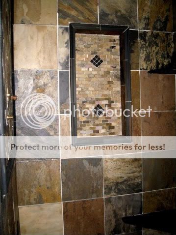

There is no given size for a niche. There are boxes tilers prefer to use because it helps make the job easier but we didn't like the way they looked or the size of them and asked our contractor to build on it custom which he did. This pic is when it was going in. We put a tempered glass shelf in the middle. The second picture includes the shelf and foot step.
Photobucketwhoer niche & benches
