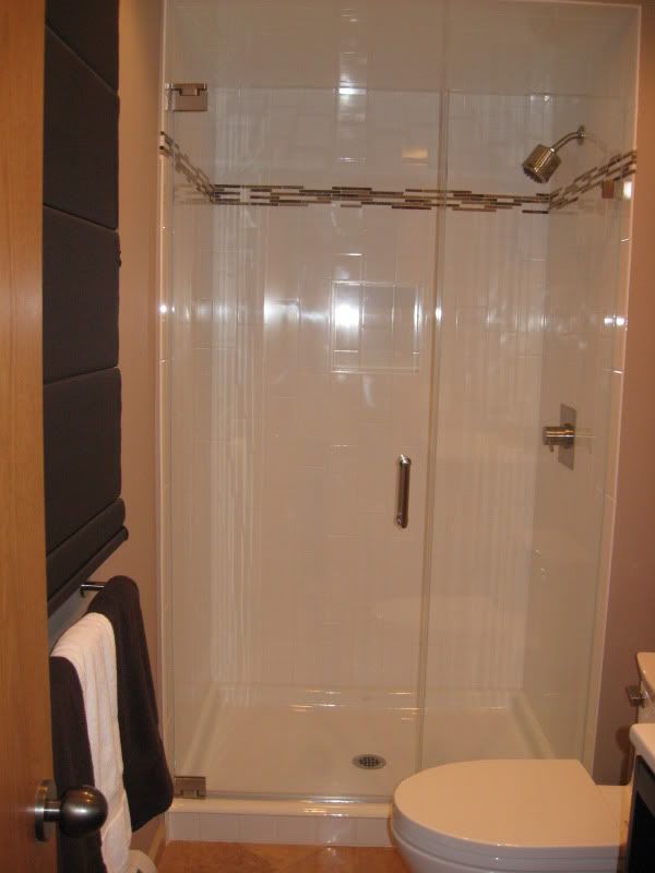

We had a Kohler cast iron shower receptor installed in our guest bathroom a few years ago. We had originally ordered what we thought was a fiberglass shower pan, but not only did it turn out to be acrylic, it had no non-slip grips. Back it went, and we got the Kohler cast iron pan instead (had originally read about them here on GW).
It's very solid, looks good, and will hold up well for a very, very long time--definitely durable. Our guest bathroom shower isn't used often, but DH and I used it daily while renovating our upstairs bathrooms two years ago. No complaints.
We think it looks great with our tiled shower walls. Tiled floors look beautiful, but we didn't want to spend what it would have cost to have one in that bathroom. The Kohler cast iron receptor definitely cost less. I don't know how a tile floor would have been with regards to cleaning, but the cast iron pan is very easy to clean.
Only disadvantage to ours is that it is cold when first stepping into the shower (our downstairs is on a slab), but it warms up quickly.
Here's a pic of ours:
View from doorway

Thanks, Cat-mom - for that good report. Is the curb part of the receptor? Your shower is beautiful!

Thanks! We are very happy with the way it turned out. We were walking that fine line between wanting the bathroom to look nice (opens to the FR) and not wanting to spend a fortune on a guest bathroom.
The top edge of the "curb" (the curved part) is the pan, the front part is tile (cut pieces of the shower wall tile).

That's a great shower CatMom!!! I like the tile with mosaic and the door really sets it off.

Thanks Todd! We used starfire/starphire glass to preserve the look of the white tile.

cat-mom, that's the type of cast iron receptor we want but when I asked about them at a local plumbing supply store, all they showed me from Kohler was something completely different. The actual floor space was quite small, the curb was wide and oval shaped. Does that make any sense? Now that I've seen yours, I'm going to ask again. Thanks for posting a pic of your shower.
