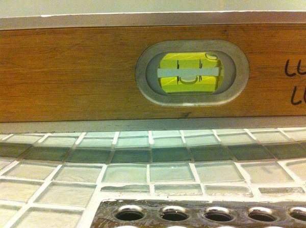

How would I know that it is pitched too little?
See the following photo for the basic setup. Make the level "level". Measure the distance between the surface of the tile and the bottom of the level.
The floor should slope a minimum of 1/4" per foot, a maximum of 1/2" per foot. Assuming 1/4" per foot...obviously the end of the level is touching the tile. Measuring one foot from the end of the level, there should be a 1/4" gap between the tile and the level. 2' away there should be a 1/2" gap between the tile and the bottom of the level. And so on.
No where should the slope be less than 1/4" per foot. No where should it be over 1/2" per foot.

Thank you very much mongoct. This is very helpful. I took these pictures before you post, borrowing the glass guy's leveler. We didnt know what to look for as far as depth is concerned. It does not look like enough, does it? I believe the shower is 5 ft. long. When he comes back with his leveler, we'll measure the drop.
On a side note, the installer had set the valves too low for hot water. He came over to adjust them. In another shower (he did two), the water was pooling at one end. The installer said that wasnt right and that he would fix it. On the above shower, I pointed the sh. head towards the wall, and the water drained some, but not all of it...maybe an 1/8" sat there. I had to push it into the drain. Now I am worried this guy is incompetent. How hard are these things to fix? He was recommended by the architect and does multimillion dollar homes!

Rockybird-- it looks to me like it's only "scooped out" around the drain, instead of pitching all the way from the walls. That may or may not have anything to do with the discoloration. If the surface is holding water because of lack of pitch (and from the picture that could be possible) this could happen, although I would think it would dry out much quicker. I still think something's going on underneath, and that pan needs to be redone, regardless of the surface pitch.
