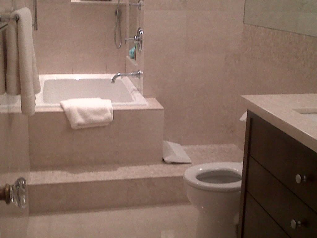

My tub filler is part of the Jado New haven line. It is really attractive and matches the rest of the bathroom bling but it fills the bath very slowly. I am not sure of the specs, but when it was installed the plumber told me that the circumference of the filler is the problem. My pipes are half-inch. The filler may be slightly smaller. Is it worth replacing and if so, with what? Is the plumber wrong? I loved my GC but hated his plumber so in my mind everything he says is wrong!

    Thanks raehelen. That was the first thing we tried. There is no flow restrictor inside, which would make sense because unlike running a sink which wastes water, all of the water filling a tub will be used. I may just need to suck it up. It is a first world problem, I know. It just makes taking a bath a bit more of a planned activity because filling it takes at least 20 minutes.

    Just to clarify, I am only talking about the tub spout itself. Does the spout have anything at all to do with the pressure? Not sure but I thought it doesn't.
    I have actually had the bathroom done for 2.5 years but this is only now starting to irritate me. I also wish that the spout was a lot shorter.
    Thankfully, losing heat is not a problem. The tub is the Kohler Greek tub. It is 4 feet long and 23.5 inches deep, so the surface area is much smaller than a regular tub and it retains heat really well--as a matter of fact, I wish it would cool down a bit quicker.
    I will keep my eyes open for sales. The current New Haven spout is an Art Deco style. Any suggestions about what might work? Also, I was thinking about the Kohler laminar faucet. Anyone have any idea if that would work?

    Is this the spout you want to see improved? I copied this off of the other active thread regarding small tubs. LWO may be interested in seeing the spout and how it is installed.

    Yes, enduring. That is the one!
