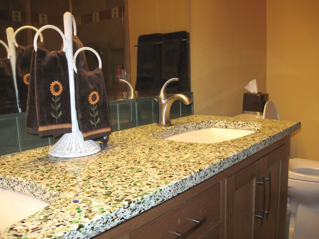

We have double sinks in a 60" vanity. The sinks are Kohler Kelston and shallow, not too large.
RE: Anyone have double sinks in 60' vanity?
Here's another photo.
kinshasa:
If you don't mind my asking, where'd you get that counter top? Gorgeous!
It's Vetrazzo recycled glass. I've got more info and lots of pictures of my finished bathroom in a September thread.
