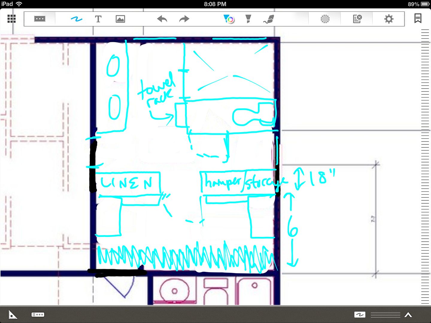

    It's a little hard to keep track of scale and dimentions, but here are a few ideas. The exact measurements would have to be figured out, but a place to start! I'd try to maximize the natural light where possible, so I tried to keep the closet more on the inside walls and also put transom windows in the shower and WC.

    I like those ideas, but I would lose the linen closet for the other bathroom. It's hard to get everything you want in a certain sized space.
