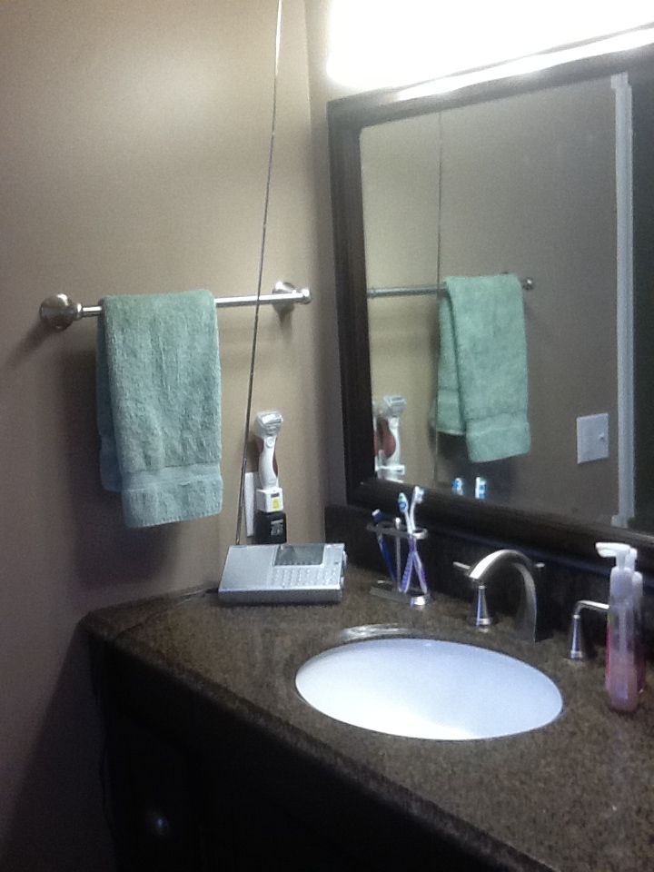

We are looking to re-do our main bathroom on the top floor of our 1969 split foyer in about a month or so. The biggest problem we have in our small bathroom is the corner which is not square at all. From the picture you can see the existing corner "slopes" back. The gap is a little over 1/2" in the back. I really don't think I want to go with a granite fabricator for this job as we are only getting a 30" vanity. I've thought about remnants but haven't gotten any pricing yet - but I know it's going to be more expensive than the "big box" options I was looking at. This is a minor update to the bathroom - new floor tile, toilet, vanity and mirror so we are on a small budget.
How do we correct this not square wall for the vanity top? Should we just bite the bullet and have a granite company make the top custom to the wall? Thanks!!

    If you're going to have a granite backsplash, you could consider having a "side" splash as well. That would cover the gap.
    You could float out the wall with mud, but a 1/2" gap is almost a little too wide to float out, even using several applications of feathered mud.
    Another option is to score and cut out a slot in the drywall and slide the granite into the slot in the drywall. That can be difficult if the granite is captured by walls on three sides.

    @mongoct - I thought about a side splash, but I don't know how that would work with the gap being in the back of the vanity and meeting the back splash.

    Can you just scootch the vanity over to the right (towards the toilet) by an inch or so, so that it looks like you wanted it away from the wall? If you had a furniture style vanity, that's how you'd want to install it anyway.
    On the notch option, just push the vanity top against the wall, run a utility knife along the edge where it touches, pull the top back, score along where the bottom of the vanity top was, and cut out a long skinny rectangle of drywall. Then push the counter back up to the wall. The front edge will go in by 1/2", and the back edge will just touch it. Caulk where the top and wall meet to make the edge look nicer.
    On the sidesplash option, you can either run it flush to the wall, in which case it won't be exactly perpendicular to the backsplash (may or may not be noticeable). Or you can split the difference and put the back part 1/4" away from the wall (closer to perpendicular to the backsplash) and then caulk that 1/4".

    I vote for sidesplash. You can shim it out a tiny bit at the back if necessary and caulk the top.

    Can't you just get the new counter templated to cover that space (i.e. templated out of square) and then get a backsplash that runs the whole length? That should be easy to do.

    "@mongoct - I thought about a side splash, but I don't know how that would work with the gap being in the back of the vanity and meeting the back splash. "
    We may not be on the same page, so I scabbed this photo from google images for illustrative purposes, but it shows that:
    If you install a flat granite top...then install a full-width backsplash...then install two side splashes...
    The thickness of the left side splash will cover the 1/2" gap at the back between the vanity top and the out-of-square side wall.
    Sure, the side and back splashes won't meet at a perfect 90-degree angle. But even if you simply butted them together, you'll probably caulk the joint, so it won't be noticeable. And with a little effort, if you really wanted to go to town you could relieve the back edge of the side splash by a few degrees so it butts tightly against the face of the back splash.

    We've thought about going down to the 24" or 26" vanity, but I think we need more space. The more we look at it, the more we are thinking we need to just go with a templated granite and have it custom made to fit the space.
    The idea of the side splash sounds great BUT I think because the space is in the back side of the vanity, either the side splash will wind up being too short in the front side of the vanity or the back splash will be too short on the right side of the vanity.
    Unfortunately we can't "scootch" the vanity over to the right any more as it is already crowding the toilet a bit.

    @palimpsest - yup, hubby did rip out the drywall and fix the wall. Bathroom was finished about a year ago. We found a 30" vanity with granite top at a local building auction that works great. We love our new bathroom. Thanks! :)
