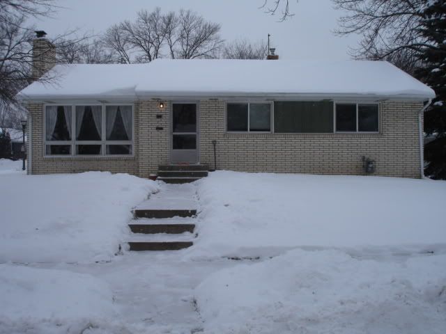

Thanks for the input. I was considering adding more closet space to the main bedroom as well. (2) 5' closets would seem like enough or one 5' and one 4'. The issue with making the front room a master suite is that it is at the front of the house, which is kind of odd as mentioned. Yes that is the front door. As far as load bearing walls go, only the exterior walls are load bearing, which may be somewhat surprising to some. Its your typical gabled rambler. The basement is not a walkout, but I do have nice height 7'6" and large egress windows in the 2 bedrooms downstairs.
I have attached a picture of the front of the house to give a better idea of where the bathroom would be located from the outside looking in.
Front of house in winter.
