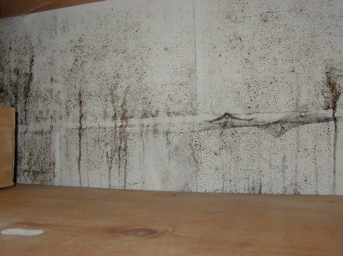

As the picture below illustrates, mould can grow quite well on the interior foundation wall with virtually no obvious food source.
Mould and moisture expert Daniel Feldman notes that "Preliminary data shows that very often I find severe Aspergillus sp. or Penicillium sp. infection of fiberglass over damp crawl spaces and in damp building walls against below-grade foundations, even when there is no mold actually visible on the insulation or its kraft paper facing. On below-grade building walls that are to be insulated I prefer solid foam insulating board as it does not hold moisture and is less mold-friendly."
Mould growing on a basement block wall.
Here is a link that might be useful: Mold prevention
