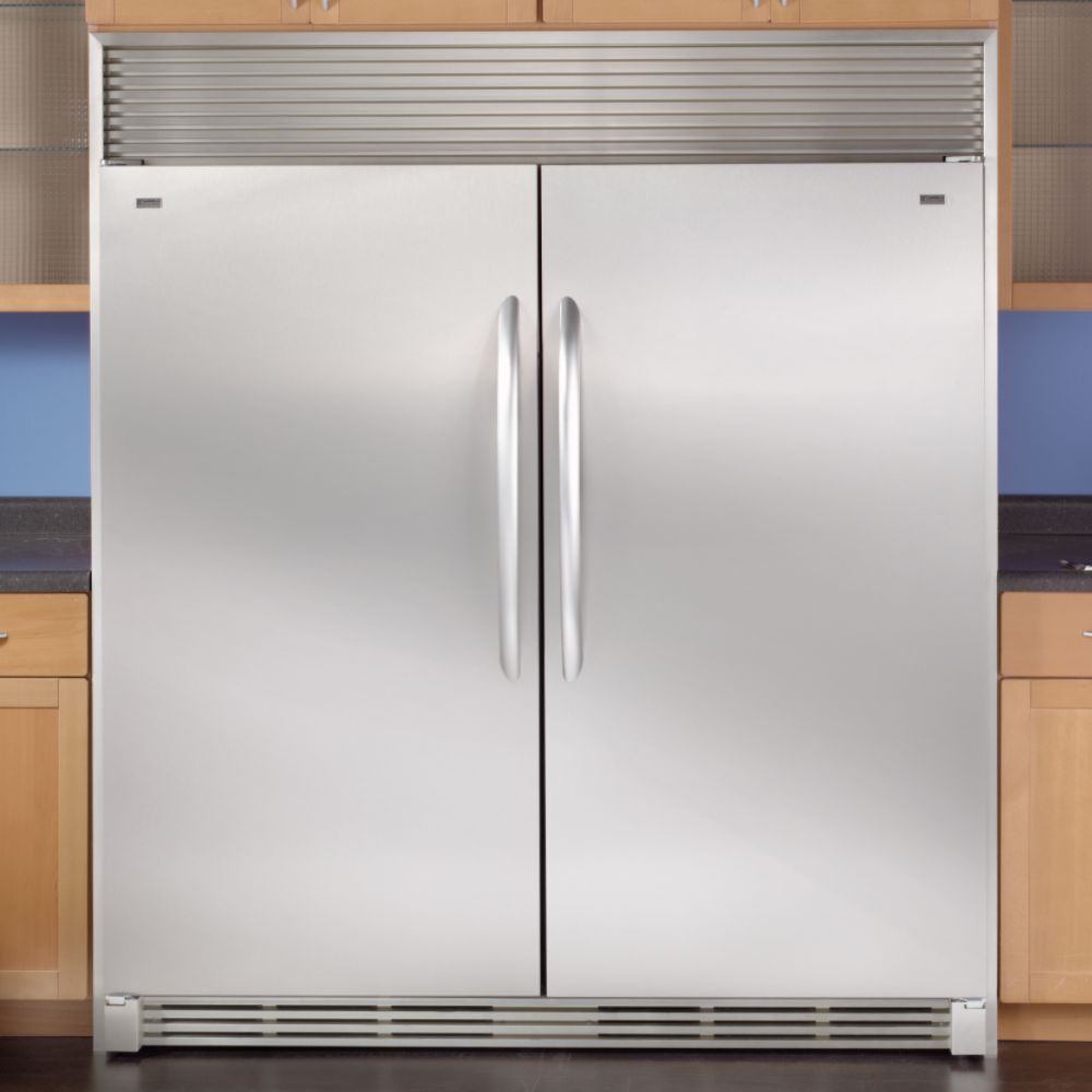

I'm lusting after this looks-like-built-in-but-isn't Kenmore Elite pair, which is actually just a nice separate freestanding 32"w cabinet-depth fridge with a same-size upright freezer next to it, surrounded by an optional trim kit that makes them look like a huge Sub-Zero with an overhead compressor. The two of them cost 35% what a real set of built-ins would. I may need to keep them separate though, or may not have room enough and have to stick with a boring 36" side-by-side freestanding fridge.
