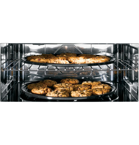

    You have to dig into the specs PDFs sometimes to get the full story (the overall space inside is similar due to the OTC version being wider and a bit taller. Or look at photos - this is of the A240 Wall Oven model; these trays are much too wide and deep to fit into a OTC oven:

    Thank you for that information. I should have noticed the discrepancy in depth you pointed out. It makes a difference for sure. My problem is that I just don't think I can have a true wall oven anywhere in the kitchen. Haven't found enough room yet on different layouts, so I was thinking range and a MW over the counter, but a speed oven would be really nice to have for everyday use.
    At least you verified they both function the same. That's good. It will come down to whether we need the extra depth or not because we will have a regular oven in a range at the very least.
