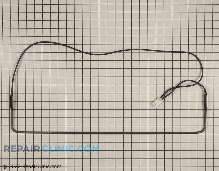

It's a U-shaped heating element mounted under the cooling coil, with a wire coming off each end. Looks similar to a heating element in an electric oven.
Wrap a couple loops of bare copper wire around the element directly over the defrost drain and run the remaining length of the wire into the drain. Doesn't have to be a long length, just enough to extend into the drain. Wrap it securely enough to insure physical contact with the element for conducting heat.
Of course, UNPLUG the refrigerator when doing this.
ET1CHEXVT01 Defrost Element

Thanks dadoes, that's exactly what I needed to see.
