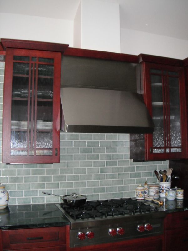

    I have had a Best hood by Broan for 4 years now and it has been a great hood. It is a WP29 on the wall over my Wolf Rangetop. It is very quite and realy gets the odors and grease out. The baffles can go in the DW and I just wipe up the rest of the hood. I think it was a good choice for our kitchen.

    Kalapointer - just wanted to say, very nice setup! Love the hood, love its clean lines. And, curved edges with no sharp corners - awesome. Actually love the whole thing (backsplash, cabinets, counters, and those red knobs!)

    Awesome range area kalapointer. Love the tile. Where does the hood vent to? Does any of the ductwork have to go through your cabinets? Unfortunately mine will have to make a right turn and go through the top of my new custom cabinets to vent outside the house. If you have a setup like that, I'd love to hear how it worked out for you, and maybe see a pic of your ductwork!!
    Also, can I ask how high above the range you mounted the hood? Thanks!!!
  • kalapointer
    9 years ago
    lydia - the hood vents up into an attic space where the inline motor is and then the duct turns and vents out the back side of our house. Since the motor is above the ceiling it is very quite. The hood is 30 inches above the range top. I took another photo so you can see where the vent goes up above the hood. I have been very happy with the hood and it is easy to clean. Good luck with your decision on a hood.
