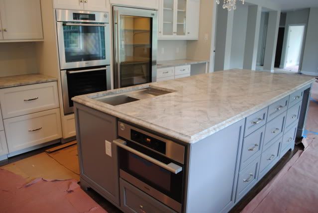

Haven't lived with it yet, we take possession of the house next Friday....but that is where ours is. The steam oven is in the island as well. Ignore that ugly white receptacle which will soon be changed to blend in...
