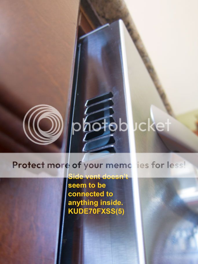

6 years agoThis comment won't get read by a lot of people. But to summarize there seem to be two alleged sources of moisture venting discussed here.
1) Vents on the top side edges of doors. Unless your dishwasher has vent tubes connected into the door (show me the dishwasher that hast that), the likelihood of significant steam emitting from these passive vents seems far fetched. If the door's inner panel is well sealed (and it has to be to protect the electronics which further get dedicated sealing) then not much moisture is going to get out those vents. I think the real problem is overly moist air is evacuating out a port on the bottom front of the dishwasher (on bottom left front edge of most KA / whirlpool / kenmore / frigidaire variants).
2) moisture leaking deeper on the side, such as on the left side evidenced a couple posts above. What I've learned from this thread and elsewhere is KitchenAid et. al. have had a faulty inlet valve / connection. KA has attempted to address the problem with a flimsy plastic cover for the insulation blanket which seems like a cynical attempt to prevent moisture from reaching the side cabinets or the insulation. IT DOES NOT WORK. Instead of fixing the problem they kicked the can with a kludge. Seems like class action fodder to me.

6 years agoBagofchips, in response to your 1. Vent comment, all of the dishwashers early on in the comment string including mine (circa 2013 Kenmore Elite, aka Whirlpool), have a vent tube connected into the door - fact, not far-fetched. There is a vent into the tub that connects to a vertical tube that travels down the inside door panel and out the toekick. The only thing keeping steam out of the door panel cavity is a damper on this tube that malfunctions. There is a large gap in the vent tube structure where on some models a fan is housed. (see Geobrick's photos further up the chain). The fan also malfunctions (not all models even have the fan assist). The controls themselves are not sealed against steam in the door cavity. Trust me, I've had 3 service calls plus have taken this door apart myself. The controls are exposed to steam in the door cavity. There is a lot of steam being allowed into the door cavity when this damper malfunctions, which then comes out the side door vent. The vent tube itself also penetrates a plastic vapor barrier at the bottom of the door panel through just a cut opening - not sealed/gasketed in any manner. This further allows steam from the tub to get up into the door panel. Older models do have a vent into the tub. If you take the door panel off immediately after a cycle, the whole inside panel has condensate all over the back of it, and the insulation is wet. This occurred even after we disconnect power to the vent damper and completely sealed off the tub penetration. At this point the steam was coming up through the vapor barrier around the vent stack. By the time we realized this vapor barrier had been factory compromised, my controls had been steamed/ruined and it wasn't worth the close to $300 for a new control system.

5 years agoThis is happening with our Jen air pro model too! The design is so bad I can’t even understand how this past engineering.bagofchips
5 years agoSide venting like that is pretty dumb. They could have at least vented the louvre outward. My fan blower is on the bottom... presumably to toss air out from beyond the general dishwasher vicinity. Wow your drawer fronts are even made of wood not MDF like mine and the wet / dry cycling has induced splitting.
