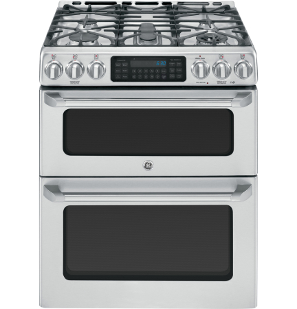

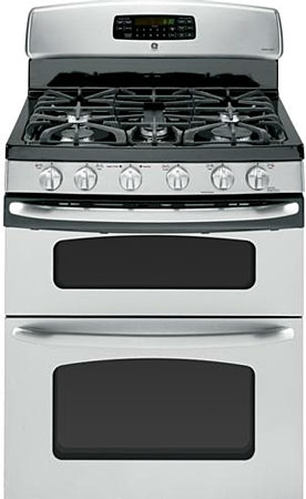

I second the thought of two side by side consumer grade ranges. I don't know what your budget is, but if you're willing to forgo convection, you can get two 30" 5 burner double oven ranges for less than $3500.
$1754 @ ABT and maybe less elsewhere
If you want something sleeker looking that will look better paired, and have a higher budget, the GE Cafe has the 5 burners with a griddle, a 20K tri ring burner, the stainless top, convection cooking, and double ovens--with self clean.
CGS990SETSS
Roughly 3K but you might talk a local place into giving you a deal if you buy two.
Here is a link that might be useful: JGB870SETSS
