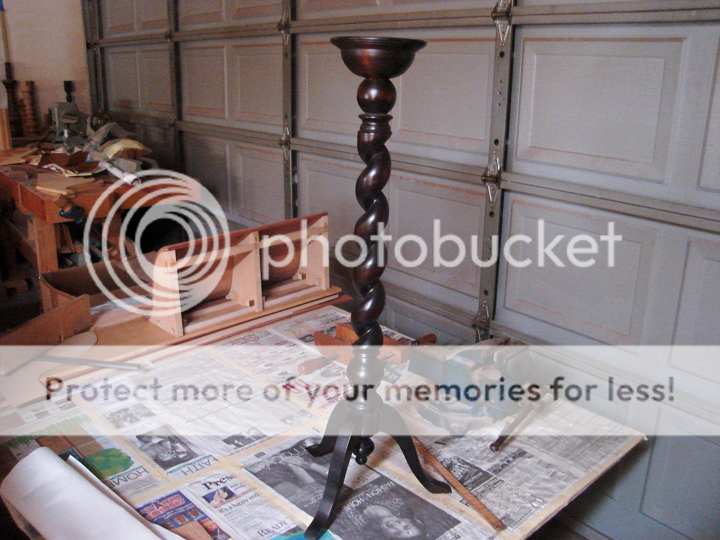

Here is a plant stand that I made a while back. What are the twists named? How are they made? What wood (pretty unfair, I dyed it black)?
RE: Easy quiz
Here we would call it "barley twist". I can't even begin to guess at the wood, but...pine?
RE: Easy quiz
Total guess on the wood but I'm thinking maple - close grained, doesn't split easily and if it's stained dark enough it looks much better (more even) than a lighter stain.
I also would call that barley twist. As for how the barley twist is done - could be started on a lathe when the top and bottom turnings are done but not finished there. Perhaps a router then hand finished. Unless you have some kind of magic CNC machine??!!

I would guess pine only because I probably wouldn't paint walnut or cherry. Could be maple as dlm said, but I like that natural as well. Obviously, I am no expert. Looking forward to the answer.

I'll take a stab. ;)
Barley twist.
Router bit.
Maple (cuz I see little if any open grain and have seen many references to maple being dyed rather than stained -especially on new or refinish projects anyway - since it's a trickier wood to stain.)

It's popularly called barley-twist, but it's technically spiral turning. Done by hand or on a specially rigged router-equipped lathe.
If I were asked to make it, I'd use mahogany, which is a wood God came up with just for projects like this. But then again, Bramante made the 20M tall baldachin columns out of bronze (in St. Peters) they were the same idea, basically, except they weigh 10 tonne each, and are elaborately-worked.

Barley twist is correct. The way it's made is you turn the balls and beads and round the center portion on the lathe, then while still mounted, mark out your grids and carve the barley twists with a carving gouge while the lathe is not turning. Made this way for hundreds of years. Done on the router the twists would be much smaller and more perfect. Obvious it is machine made. This type of twist was a major element of furniture made in the 16th and 17th century and is still used today. Here is a company that makes serious reproductions. The price is probably, if you have to ask you can't afford it. Much of his work are copies of museum pieces. Even in the 1500 or 1600's, furniture with barley twists would tend to be high end because of the amount of hand labor. The wood is poplar, commonly used and a secondary wood in antiques and also used in antiques as faux walnut.
